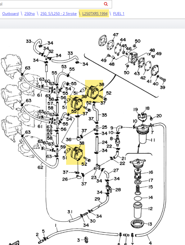

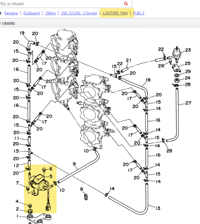

Well the last picture of the main fuel pump definitely is...and like I said...doesn't stop clicking as soon as it gets power
Honorary Supreme Mariner
40,028
Parts book shows 3 identical PRESSURE operated fuel pumps.------Good luck with this motor.

There is three vertical yes....and there's one that's on the bottom as you can see in picture
Jakem
Apr 25, 2021
1,109
Right there

All right well....the clicking stopped from fuel pump....and now boat won't run so there we have it....any idea of what fuel pressure should be so I can replace the high pressure pump

???-----The motor should start and run with fuel pumped into the carburetors with primer bulb.-----Buying a new ( $$$ ) electric fuel pump might not be a wise step.
