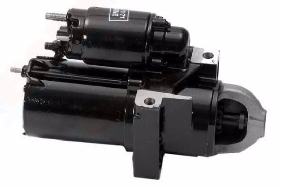

Hello everyone, I will be changing transom assembly real soon.
I want to change starter at same time, Engine is a 383 Vortec block,
with a stock GM marine unit
I can't seem to find the correct part number for a PMGR starter,
Anybody help me out here ?

there are 4 configurations of starters for GM engines. direct drive and PMGR, straight across pattern (for 153 tooth flywheels) and the staggered pattern (for 168 tooth flywheels)
so what flywheel do you have?

Ok, I'm feeling pattern of bolts is across from each other, not staggered.
I'm wanting to install a PMGr starter in it, unless you know of something better?

are you certain? there should be both patterns in the block.
Which one was on there? you may need to count your teeth if you dont know.

I know , I been building GM engines a long time, Problem is, engine is in the boat and I can't get my hand around it to know,, Thiinking I'm gonna have to wait to get it out to know for sure.
I do know there is 2 bolts in it, not staggered

Ayuh,..... Got a phone,..?? reach down in, 'n take a picture,.....

if the starter is there and straight across, you have a 153 tooth flywheel.
