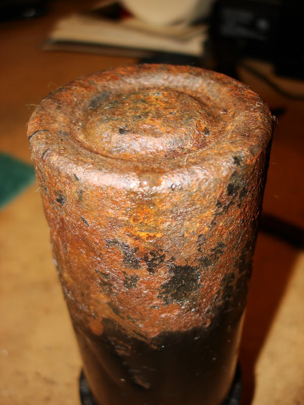

Ever had one of those "why didn't I look at this earlier" moments? After reading your reply I decided to pull the coil to bench test it. Now the funny thing is, I had bought a spare coil and took it with me to the lake yesterday, but didn't have time to try a swap.
Coil looks fine from up top, and is a little hard to get to/see since it's mounted on the back of the engine.

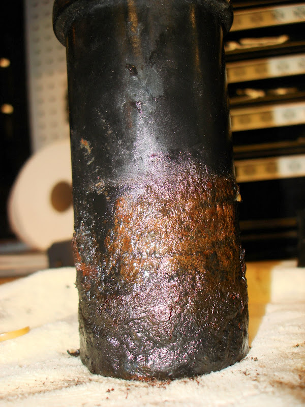

Here's what I saw last night when I pulled it off. The engine is very clean and free of rust or oil leaks elsewhere so this was a shocker:
After scraping the rust / paint off the oil leak is obvious. Shaking the coil I can't hear any oil inside sloshing.
So the oil is to cool the coil internally. And it's obviously got little or no oil inside. Add heat, and getting shorting internally I bet. It does ohm out fine on the bench, I'm thinking about putting it in the garage oven and get it up to 150F or so and see if the resistance changes!

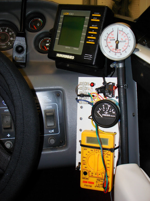

For you "expert troubleshooters" out there, here's a picture of the fuel test rig I have used the last few times out. Overkill? Maybe :)
From top to bottom:
- Mechanical fuel pump gauge tee'd into the line to the carb
- Red LED showing fuel pump is running
- Switch to manually activate fuel pump
- Electric fuel pressure gauge (not connected) to compare w/ mechanical
- Voltmeter which shows voltage at the fuel pump (spliced a wire in)

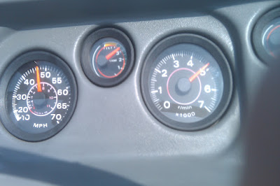

Went out today and ran it all day long with lots of WOT runs up to 50 MPH on the GPS and well over the rated WOT rpm (saw 5k once!) for a 97 vortec engine. She's quick (to me, since it's my first boat).
