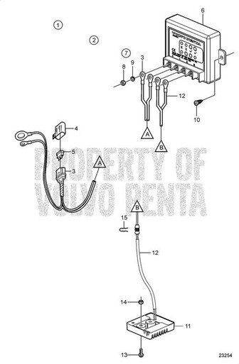

At this point, because all cylinders fire with starrer fluid and i know the individual combustion psi is within spec, i am thinking it is either bad fuel or the injectors arent getting the signal to fire. I did notice that the Electronic Unit - Volvo Penta (3862332), was disconnected (see pic). I have since reconnected it. The 1A fuse was also blown and replaced with 2A (could not locate a 1A fuse). Same, no start, issue persists. I do notice the EU has lights, but I have never seen these lit. Here is some info i found on the EU...
Sounds like this thing is a big deal.
-How can i test the EU to know if it is good?
-Does it really control the fuel and ignition systems?
-if system fires on starter fluid, could i assume the ignition coil/operation is fine?
-should the EU lights be on? What do they mean?
-How can i test to see if the injectors are getting a fire signal as required?
-Is there a way to test fuel?

The "E. U." you picture is the Active Corrosion Protection control unit. It doesn't have anything to do with your won't start.

As MUC stated, that device you have pictured has nothing to do with controlling your engine, it is for corrosion protection of the drive. Do a spark test with a test light or ground a screwdriver to the block. Have you pulled the distributor cap and checked the cap and rotor for corrosion. Replace if any. Get an electrical tester and make sure that you have voltage to the coil. Check fuel rail pressure with the proper gage.
There will be a sticker or plate on your engine that will list the engine model, spec number and serial number. This information will be needed to give you accurate advice.
the next step in troubleshooting your problem is testing the fuel pressure.
Your engine has 2 fuel pumps, they should both be tested with a fuel pressure gauge.
Thank you for the replay MUC. When i go to the following link and read the discription, it says this control unit is responsible for controling the fuel and ignition. Seemed a little far fetched for me but i was only going by what i read.
