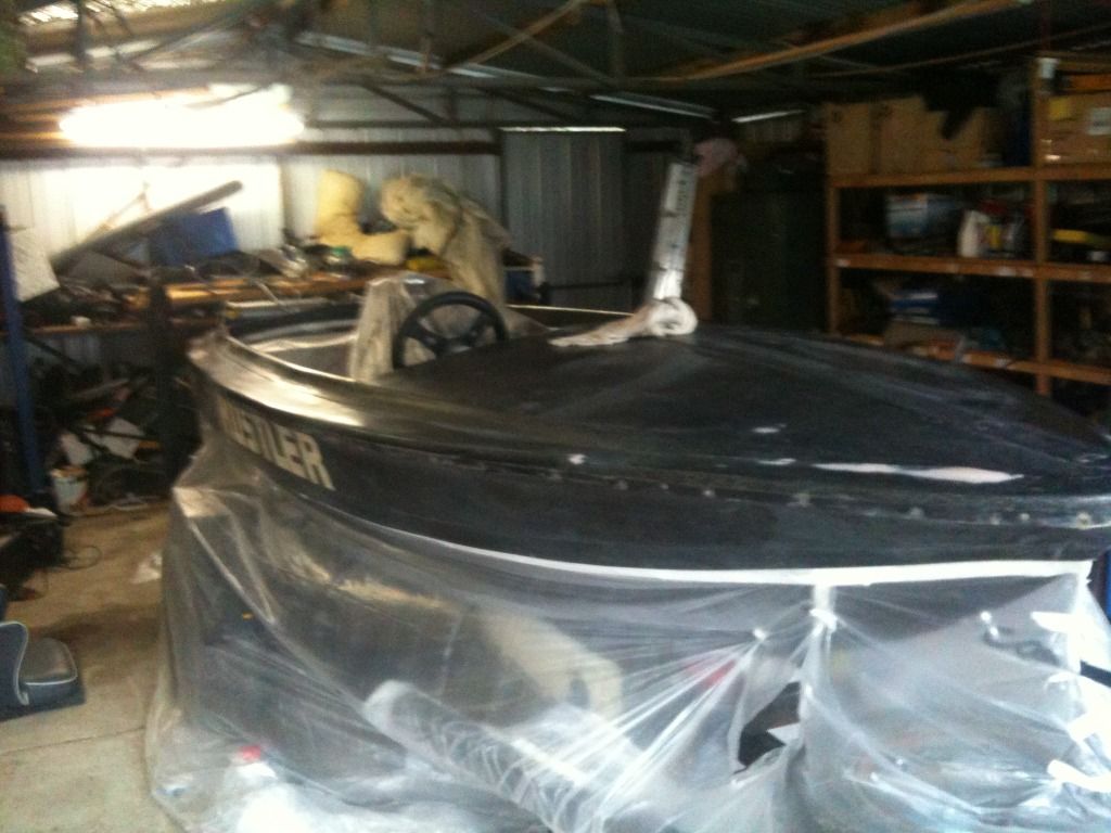

This was the last thing that i had painted (got a mate on the gun in the shed, he's better practiced than i am and trust him with the job)

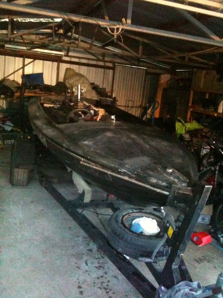

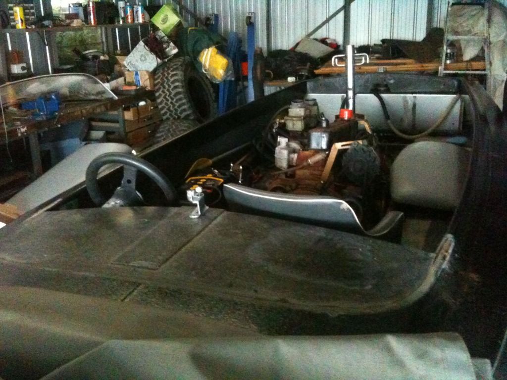

This is the stage im at at the moment with the boat, just pulling everything off it ready for paint sanding:

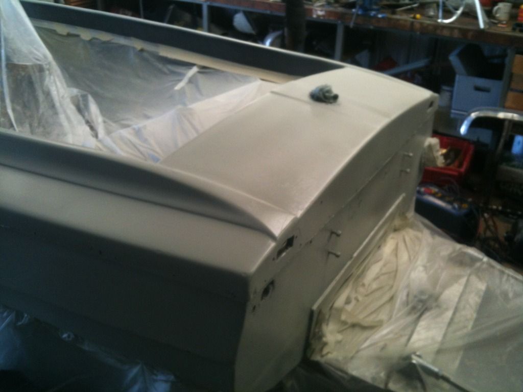

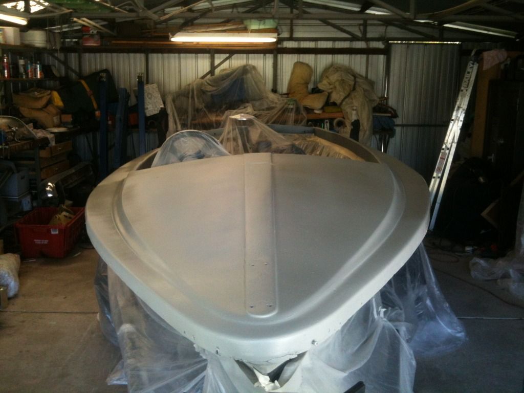

Figured i'd chuck up some progress pics:
At Hi-Fill stage at the moment. Will get colour next weekend!
