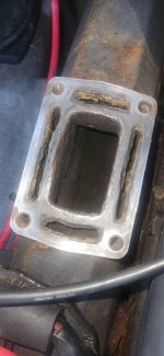

I was cruising the harbor on Sunday with friends and noticed overheating at the port exhaust elbow. The engine temp gauge was only slightly above the midpoint, so it was approximately 172 Deg F. The starboard elbow did not seem as hot.
I was expecting to find rusted and blocked passageways in the elbow, so I removed it. It was easy to do, remove 4 bolts and 2 hose clamps and the elbow, along with the round exhaust pipe comes out. See pictures
I think that I found a different cause. The hose from the thermostat housing to the exhaust manifold was very cloged and the outlet of the thermostat was rusted and had narrowed down to only about 1/4 of an inch.
Questions: As you can see on the picture. I have not seperated the elbow from the exhauts pipe. Any suggestions?

I was able to separate the round pipes from the elbow. A few hits with a rubber mallet was all it took
After looking at the elbows more closely and checking prices, I have decided to replace both elbows. I can get both with the gaskets for under $250
I will clean and repaint the round pipes. That way I will be sure that I get a good seal with the rubber hose between the pipes and the elbows.

I have that style exhaust on mine and I used the gaskets with the 4 open sections. That elbow that you posted a pic of was definitely in need of replacement given the level of clogging seen so that's a good choice.
With this job the issue is making sure that the sealing surfaces are flat and level, and that they are not pitted with rust. Leaks around those gaskets into a cylinder are quite common and cause a lot of damage. How do the cooling passages in the manifolds look? If they are as clogged as the elbow you posted I would at least try to rod them out.
The passages in the thermostat housing also get clogged/necked down over time you can rod them out with a coat hanger wire. That clogged cooling hose was probably the cause, what was clogging it? Might be able to re-use it if you can blast that crud out with a garden hose.

I'm cleaning the mounting surface on the top of the exhaust manifold where the gasket will be, and on the port side there is a very hard sealant or something. BTW, that is the side that was overheating. The sealer (?) is lime green and comes off with a lot of scraping. Could it be a filler used to repair the gasket surface? Maybe I should not be scraping it off!!! Any thoughts? I'm going to create a separate post just on that topic.
I have been using a shop vac to suck up any debris.
I was going to switch to a sanding block and sandpaper, but I will wait and see what you or others say first.

Here are pictures: The first one shows the green material. The next 2 show the manifolds after cleaning them up as best I could.

Agreed I would not chance it, esp in salt water. Not enough left for the gasket to seal.

2XS with BONDO. Those manifolds are going to cost you a new engine if you do not change them.Check out the price of a rebuilt Jasper or similar rebuild plus labor, freight and tax.

Ayuh,..... That means they are agreeing with my post #12,.....
Running that manifold will cost you a new motor, because that manifold is rusted out,.... The gasket sealing surface is but a small part of a rotten manifold,... At some point, fairly soon, that manifold will dump raw water into the motor, 'n if running, a bent rod, or worse will be the result,.....
All that rust you're cleaning out of the manifold, 'n the t-stat housing, Used to be cast iron,.....
To save your motor, I'd replace the manifolds, 'n the t-stat housing,.....
They're long past just cleaning them up,......

You will get salt water in a couple cylinders because there isn’t enough cast iron left for the gasket to seal. Look at the pic that I posted of a new one, the sealing surface is much wider. Like 3/8ths” to 1/4” wide. So it will either rust up exhaust valves if a small amount of water or hydro lock a cyl if a large amount of water. Most mechanics here will say replace both by 7-8 years.
