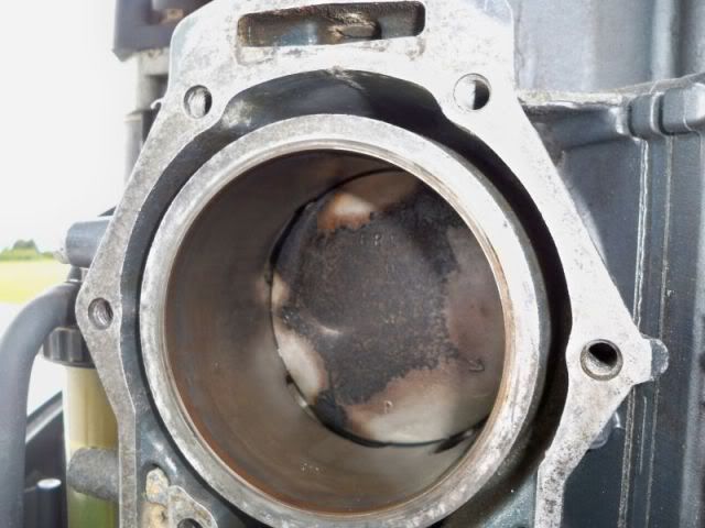

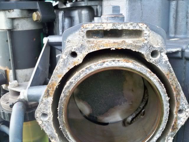

Here are a few pics I took when I did my 97 yam 115. This is before & after of the area around the cylinders:
Here is what the inside of the WJ cover looked like along with the Gasket:
Here is an after pic of the head and WJ cover (forgot to take a before pic of the head):
The job was a real pain in some areas but not near as bad as I was expecting, just take your time. Sure saved a butt load of cash doing it myself.
