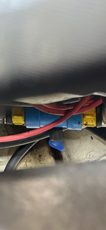

After much trial and error I have determined that there is a restriction between the high pressure side of the impeller pump and the inlet at the Tstat housing. I have been told that the only part of this pathway that collects debris is at the oil cooler which I confirmed prior is clean. What is the blue and yellow plastic thing inline between the power steering cooler and the cool fuel cooler? (Pic atttached)
Buddy at the Marina says it looks like a check valve but I have flushed and back flushed past it and if its providing any resistance its from its proper flow from impeller to tstat.
I'm thinking this is likely my problem.

Yes that is a check valve to help keep hot water from getting to the fuel cooler pump system… Merc part number 21-862271A1.
It could be an issue… but I just now saw where you mentioned you had bell housing type service work done… I would first thoroughly double check the intake waterline hose located on the outside of the boat between the bell housing and the transom assembly. I would suspect the hose has a twist or kink in it from working on it… it’s common to get that twisted up even if you’re trying to be careful.
Here’s what the check value looks like in a package new,

Update:
I fixed it by flushing and back flushing with water and air compressor until the check valve prevented backflow. I was surprised how much debris came out.
