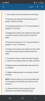

I followed instructions in Mercury service manual posted by Don years ago on this site. Not correct?

The list does show 7-10 first and is a good test. Over time there has been many discussions on this topic after Don had passed. These discussion is also where the slight vacuum came in. While it should not have leaked, it did. Try with 5 psi and see if it leaks
