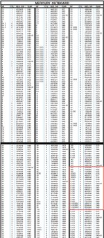

1980 (to be verified) Mercury Black max 150hp. (S/N 5503928). Now I believe it is a 1980 but not entirely sure.

1. Based on the Serial number does anyone know the exact year and spec? See attached spec sheet
2. Is this fuel leak likely associated with a low end bug with float bowls? My understanding the float bowls effect idle and low end power but once main jet is used then there is no issue
