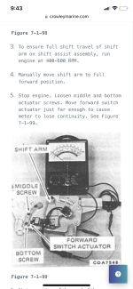

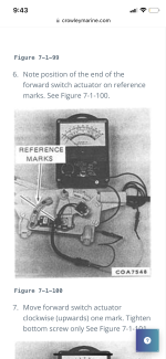

The over stroke switch is supposed to
Disable the ESA while in gear.
So on the water, as soon as I move the shift
Cable towards neutral(while in gear) the ESA switch should be depressed and as soon as the over stroke switch is free, the ESA kicks on?
The manual was a bit confusing.
It said to turn the shift arm to full forward or reverse, adjust over stroke actuator until continuity is lost and then move actuator up 1 point. Up 1 point for continued contact I am assume.
I did this, but it seems the actuator releases the over stroke switch after I am already in neutral.
Is this also another case of “on water it will act different”
Thanks.
