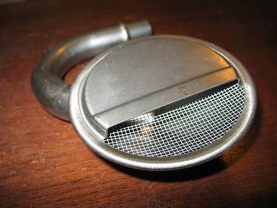

If the oil psi goes up with adding more oil (or even adding a higher weight seemed to work too for this test too) then it has been my past experience with engine models around your model year that the oil pickup tube "Screen" had fallen off the tube laying on the bottom of the oil pan and by adding oil temporarily raised the oil level for the tube to help suck it up better.
https://www.ebay.com/itm/Screen-Oil-...4AAMXQVERSvapM
https://www.mercruiserparts.com/bam/...31849/8093/140
