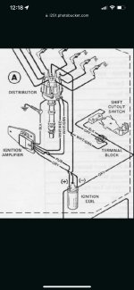

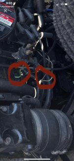

Noticed one of the two wires from shift interrupt switch is sitting disconnected behind the cap..
Also noticed the white/green from distributor rear is spliced into another wire.

See ya learn something every minute… what is this little button you speak of? And I understand it needs to be Hooked up I’m just not sure to what lol should that wire from the interrupt go to the bottom of the distributor white/green wire?
