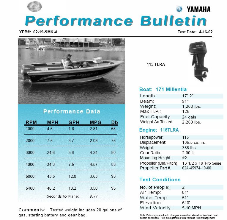

According to Yamaha tests, a 1260 lb boat with a 360 lb carbureted Yamaha 115 will burn typically burn 6 or 7 gallons per hour while it's on plane. That'll be 4 or 5 miles per gallon. I would expect the 115 Mercury to use slightly more fuel than the Yamaha, say 7 or 8 gallons per hour, 3.5 to 4.5 MPG. A friend of mine has a 19' Mako with a mid-90's Mariner 150, gets between 2 - 2.5 MPG.
You'll have to decide what a typical day would be on your boat. Cruise 15 minutes to a beach, lay around a couple of hours, maybe tube for an hour or so then head home? Cruise 1/2 hour to a fishing spot and fish for a couple of hours? My point is that you will not be constantly running the motor. The typical boater puts less than 50 hours per year on their motor. Figure 10% or so at idle (no wake zones, etc), means you'll probably run 40 - 45 hours at 7 gallons per hour. You're probably looking at 250 - 300 gallons of gas, which will cost you somewhere between $1000 - $1200.
