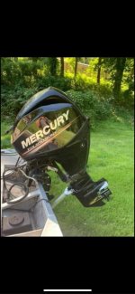

This old tired motor, I think is gonna need some serious love. I need to start a project this is a work boat I ran out of time to try and save some $ and ended up buying a almost new 25ELPT.
now I get to rig it and restart my learning curve and figure out the care and feeding of a newish four stroke?
Can the run hours be verified by a dealer scan of the ecm? Is there a way to do it at home? I noticed Mercury has engine monitoring apps and wonder if they work with the smaller engines.

I dont know much about the new motors but man, that looks sexy hanging off the back of your boat. Nice buy!!
Watermann
Jan 12, 2013
13,860
Love the looks of the newer Mercs, very sexy motors. Some of the fellas in the Merc section should know all about the newer 4 strokes.
