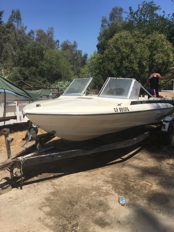

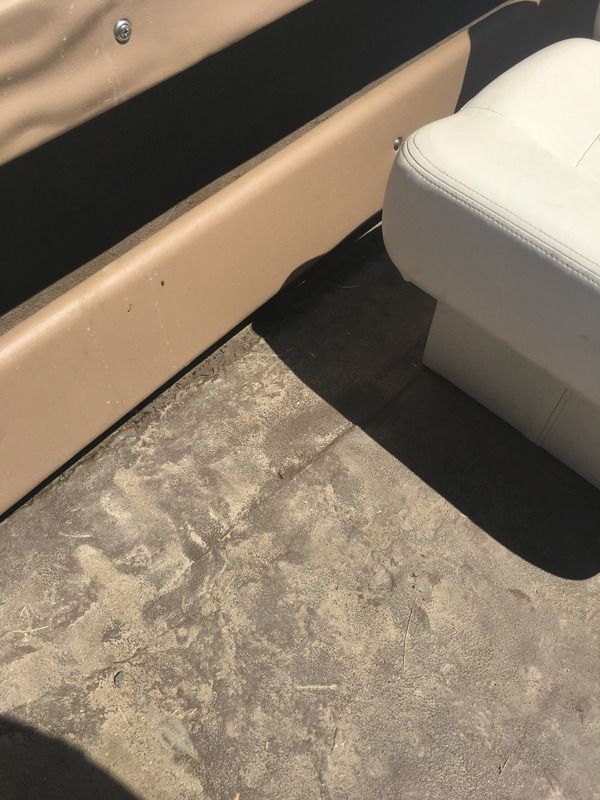

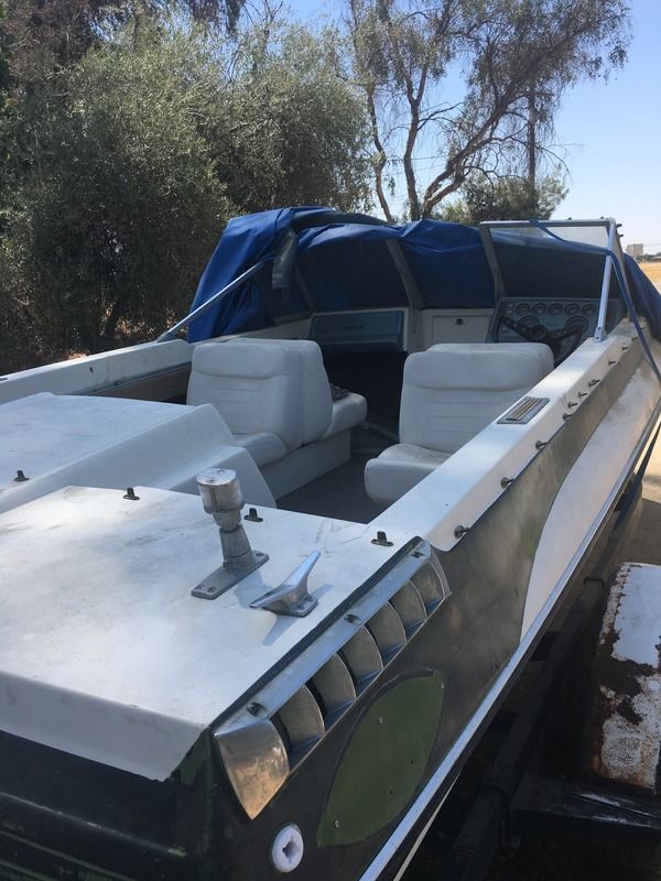

Here's some of the pics that I managed to upload. Sorry If they're massive!

Based on the one stern pic, I think we are talking an I/O Volvo-Penta (right?)
the replacing the floor stuff is a little scary . . . usually that means the mess below was just covered up. No way to tell but take a look where you can see below deck. Open up hatches, etc and take some pictures and post them.
If the structure (beneath the floor) is good, then you have a chance.
Since the engine has not been run in a while, I'd pull the spark plugs, get some fogging oil in the cylinders and see if you can turn the engine over by hand. Drain the motor oil and put in new oil and oil filter.
How about the fuel? Still some in the tank? Probably more like jelly than fuel, so that has to come out.
I would take the carburetor off and give it a good cleaning or rebuild.
How about the battery . . . probably needs a new one. you will also want a portable battery charger.
Once you have new oil in the engine and if you found that you can rotate the engine by hand, see if you can 'spin' the engine with the starter to the point where you are seeing oil pressure on the gauge.
If you get that far, maybe try putting the carburetor back on the engine, get the fuel line hooked up and some fuel in the tank, and water running to the 'ear muffs' on the outdrive and see if you can get the engine to start for real.
If it does not start, you can check for spark by putting one of the ignition wires near some metal of the engine and in clear view and hit the starter again to see if you are getting an ignition spark.
