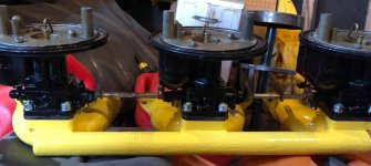

Good Lord......another year gone and still no splash. Naturally things kept popping up (more like life) that kept me from getting to the updates more often. So with that being said here is the latest and greatest, yet another year later.
Had an issue with the "clutch" springs all over inside the bell housing early last fall. Still within boating season, yet. Was on my final driveway run with the muffs before I took her to the water to see how it ran with a load.......still on trailer in the water...when after I ran it, I let it cool down, went to restart the motor froze up. I was HOT and disappointed at the same time. Another reason I haven't done much with since the last update, I was just that frustrated with it. I finally had it ready and this happened. It ran soo good over the few driveway runs that I felt good about the motor having a load on it. I fixed a couple kinks in her which were mostly carb related (getting them synced). Sooo I took the motor out (which is when I found out the "clutch" blew up) to make sure it wasn't froze up. Great news it wasn't. It was just that "clutch". I decided to go ahead and take it down to the block (with guts still in it that is) and prepped/painted everything. Just finished with painting the block. Have the gasket set ordered and on the way to get it put back together. I will have to get the pictures and download them to the laptop then post them here. Definitely a huge difference from the way it was to the way it looks now.

ok soo here are all the pics. hopefully all of them
