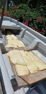

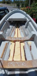

Glassed and foamed in the first 2 sections.

kcassells
Oct 16, 2012
8,743
Just running this by you. Just say yes please.
So when you cut the closed cell foam to make level you need to seal it with poxy or else it becomes open and water loves that.
Yes. looks great.
grouper242
Mar 22, 2022
25
Thanks all. I did not put resin on the foam, but maybe I'll do it on the other two sections. Each compartment is fully sealed so hopefully won't be an issue.
kcassells
Oct 16, 2012
8,743
Looks great Grouper
Not required so far as I know
Just so you understand cut closed foam is now open cell. Just a quick info
in regard to marine foam. When poured thru the deck it will attach to under the deck. And remains closed cell.
Nothing is required if you don't know or care. This is just a heads up for others is all. I thought this was common knowledge.
Boat will still float.
