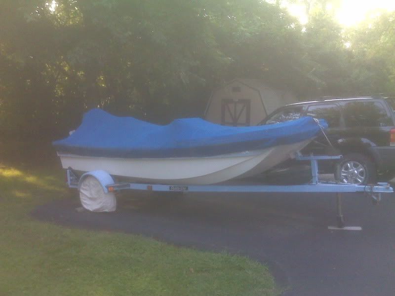

Hey gang,
New to the site, and wanted to start posting. I've recently acquired a 1983 built 17' Warrior, with a 1984 built Johnson 50hp (J50BELCRM). My grandfather had it since new, and used it very often every year up until four years ago. It was covered and stored outside, but very well maintained. It's mine now, and despite being dirty, it appears to be in good shape. Mechanically it's good, but I still plan on doing the usual tune up and fluid change.

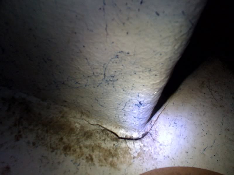

I've found a couple cracks and a soft spot that I'm really loosing sleep over. I'm hoping my fun is not sunk before I even get it into the water. I've attached some pics that hopefully will show their location and severity.
There is a crack on either side, same location, same severity. They are not very visible unless you apply a little bit of pressure to the deck, and then the crack begins to separate. Also, moving towards the stern, on the deck, about 2" before you get to the storage area (where the fuel tank and batteries are), the floor goes soft. I'm assuming this is the result of a rotted stringer or other substructure. Now, I'm not shy about tearing into it, but if it something that just isn't worth fixing, I need to know. Can I lay some new fiberglass/resin into these areas to reinforce them and help them from getting worse?
I hope you guys can give me some guidance on this.
Also keep in mind, in the last pic, I'm applying a little pressure to the deck to help show the crack.
Any feedback is greatly appreciated, thanks gang!
-Wes

Welcome to iboats!
Well, that crack isn't a big deal, as long as water hasn't migrated and rotted out the deck. Still everything is repairable... Many great threads of information. If you're at all handy, and you love this boat, go for it!

Wes, Welcome to I-Boats. I agree with Rick. this was your Grandfathers, it is worth fixing/saving. Listen heres what to do. If the floor has numerous soft spots, then you might as well replace whole floor. Not a big boat Easy Job. Dirty but easy. As far as existing cracks, if the area around them is not soft , grind out delaminations [cracks]. layup 1 layer of 1708 biaxal easy to work with], or woven roven. Then 1 1/2 mat with poly resin. Aquart would be plenty of resin for both sides. Grind once cured and fair out. Brush on gelcoat. Again check the floor for other soft spots. We'll quide you threw that at that time. Good luck Rick. Happy and SAFE Boating

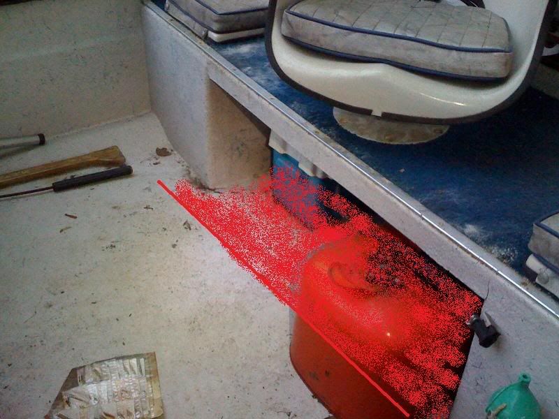

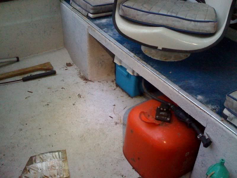

Guys, THANK YOU! I can't tell you how much I appreciate your quick and detailed responses. I wanted to add another pic, and say that the entire storage area underneath the stern seat is soft. It isn't just one small area, it's the floor of the entire compartment. Every other inch of the deck is rock solid, except that rear area. I've walked it from edge to edge, putting a good load on it everywhere, and can't find another weak spot. The raised platform where the seat is between the two padded storage compartment lids is solid as a rock, too.
What throws me off is that it goes from solid to soft at a specific point that you could literally draw a line over, that goes from port to starboard (see pic below). Is there a chance that this area was never supported, even when she was new?

There's no doubt that she can be fixed, looks to be in good shape. There is a slight chance that the deck wasn't supported there when she was new, but keep this mind. The crack has probably allowed some water to penetrate the wood below the fiberglass. If that is the case you most likely have some wood rot forming, and that only means one thing... Get it out before it spreads to the rest of the boat.
I'm sure someone here is going to say this, so I'll just get it out there. You should consider drilling a couple holes in the "soft spots" and see if you hit dry wood under the fiberglass. Of course you'll want to seal that up after you do the inspection. I'm a total newb here at iboats, but this boat is definitely worth fixing (you know that), I would thoroughly inspect it before calling it good. It may actually save you from even more work later on.
