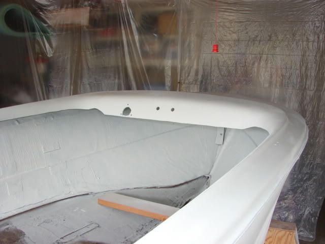

If the paint is anything like the primer, I think I am going to like it! After thinning it, I sprayed it on with a HVLP sprayer. It went on quite well. After drying (about 2 hours), it was sandable and recoatable. It forms a TENACIOUS bond with the fiberglass and wood. I used the white primer this time, For the insides of the hull and deck, and the coverage was pretty good, given that it was a white primer.

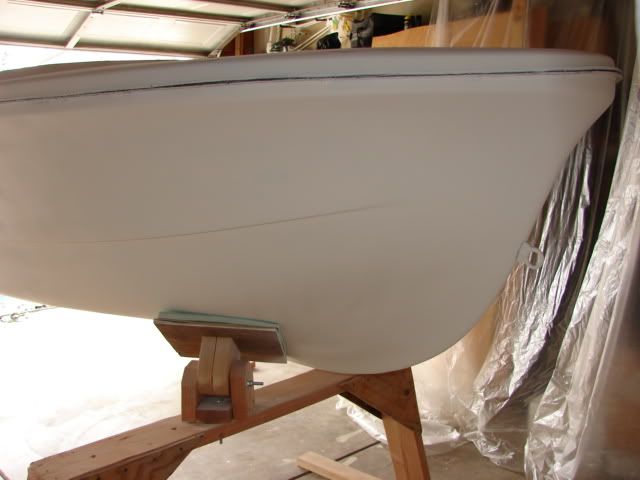

Here's my update: I just finished my last coat of etching primer (SM-664D). So far so good. In fact, this stuff is great. I'm using a gravity feed sprayer and thinning about 10% (SM-605). The primer goes on nice and dries quickly, but not too quickly. The primer has gone over old paint (sanded), fiberglass and Marine-Tex putty with zero problems. It really sticks to any surface. Next I'll be lightly sanding the whole finish and then the bottom and top coats go on...

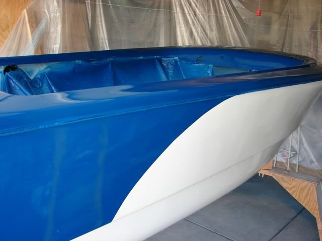

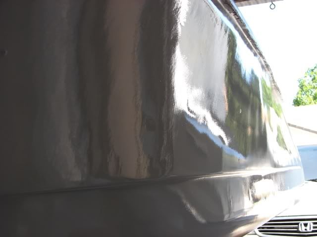

Update: Second coat of Supermarine Revolution using gravity sprayer. :D
Dry to the touch in about 2 hours and I'm giving it about 2 days between coats (this photo was taken 1 day after second coat).

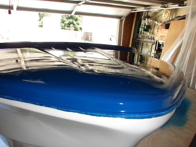

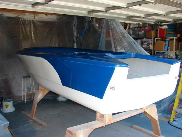

Another update: Finished! Three coats of Supermarine Revolution SM-1000 North Sea Blue.
Have you scratch tested or wet sanded/blended any areas yet?
I'm a rookie at spray painting boats, so I don't know how to scratch test or blend areas. I did very lightly sand between coats just to clear off any dust/lint that stuck to the paint followed by a tack cloth.

Very nice, What kind of Gun and compressor did you use to shoot your paint?
TregoMark
Petty Officer 3rd Class
Feb 16, 2010
84
Re: New Marine Paint??
I just used a Lowes Kobalt brand gravity feed spray gun and a 25 gal compressor. I allowed two days between coats and made sure they were applied around 70 degrees per the instructions. The white dried faster (2-3 hours to touch) than the blue (5-6 hours dry to touch) which was mentioned in the instructions.
All in all this is a great paint. I have limited experience with this kind of paint project, so take it for what it's worth. I think the results speak for themselves.
