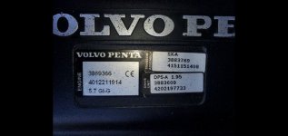

Been working on an engine replacement (long block 5.7).
We (think) we have everything back in place - new engine; outdrive mounted; new bellows etc. etc.

Serial number comes back as Gi-G
Fuel pressure low side 8 psi +/- 4 , high side 50 to 60 psi
