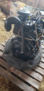

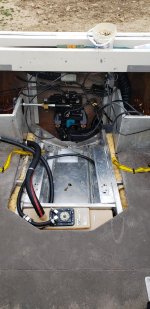

Thank you for the help. I got it out with a front loader. Lol

I got the feeling its gonna be much harder going in since you got to line up front mount studs, back mount stud and exhaust pipe. We will see.
Let it hang, start your rear mount bolts, put your alignment bar in via the gimbal bearing, adjust your font mount and then drop it down. The exhaust leave until after the mounts are down and aligned. If I recall the 3.0 has a intermediate down pipe with rubber connectors on each end so you have some wiggle, just drop down the upper connector so the elbow clears copmpletely before you drop the engine.

I tried to get the motor in and could not get the exhaust to line up. It kept coming out while managing the elevations for front and rear and left and right.
So it's in and mounted. What do I do with the exhaust? Is there a way besides taking off the manifold riser?
Ayuh,..... Slide the boots up/ down, insert the pipe, 'n reposition the boots again,....
Btw, it looks like there's a hole in the top boot,......

Thanks Bondo. I see the hole now. Thats from using a backhoe bucket to lift. Its a 1971 international. Not very smooth any more for this type of lift.
I will try looking up the parts and replace upper and lower. Soap em up and give it a try.
