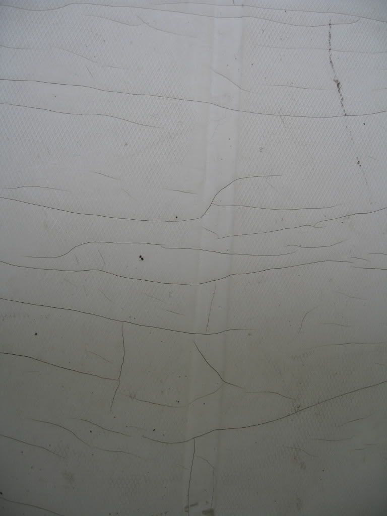

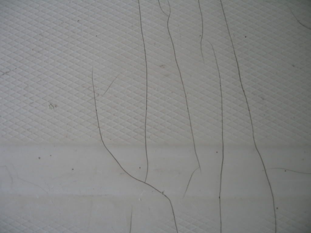

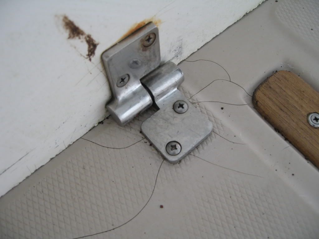

Here are some pics of the deck area that is cracked. It seems to be just in the center of the cockpit area above the fuel tank. The deck seems extremely solid. No softness or movement even when I jump on it. Deck looks like fiberglass with wood underneath. Feeling in the inspection hole under the deck the wood feels solid and dry.
I would like to fill in the cracks and paint the whole cockpit area and top of the engine box the same color.
I will change the inspection covers at the same time. Go to an 8" from a 6". A beige or light tan would look good.
Thanks for the help

Ayuh,... Them's some pretty danm BIG cracks....
Please resize your pics to 640x480,... Then edit the smaller 1s to your post...
You'll get more responses...
It appears that you have some serious grinding,+ filling,+ fairing to do...
Some of them look like raised edges,... Are they,..??
The imprinted pattern will be lost,... No gettin' around that...
When you pull a hatch, can you see the edge of the deck,..??
Is it end-grain cored, or plywood cored,..??
