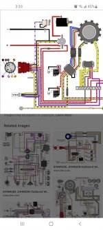

I ended up blowing the fuse while looking for the black and yellow wire. So I'm on hold until I replace that. Hopefully tomorrow. According to the wire diagram I found, this is my black/yellow wire.
