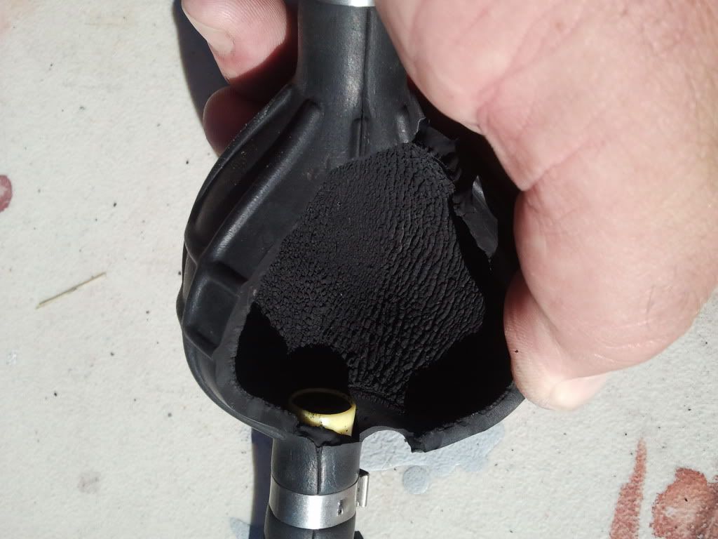

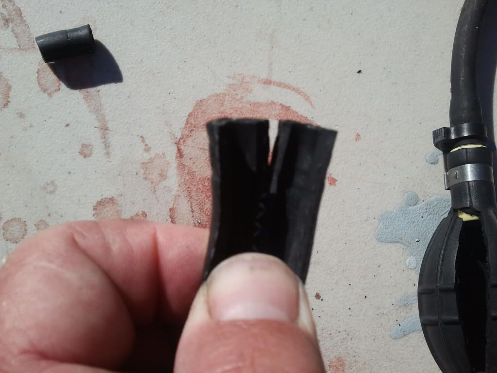

Gunk in my filter:
Inside of the who-knows-how-old fuel lines looks OK:
Less than 6-month old Quicksilver OEM bulb, not so good:
So please specifically recommend me a good primer bulb (manufacturer and part number) you have personally used, that seems to hold up to the E10 and the UV and whose check valves hold up.

I have seen many negative reviews on the Silverado 3000. I even called Sierra and according to them 3000 does suck and there is a new Silverado 4000 product that is supposed to be uber-awesome. I can't find any and I bet it will be co$tly. I don't give 2 craps about low-perm or CARB or EPA ratings on this setup, I just want something that will survive the fuel.
I have used OEM bulbs (the one in the pic above is OEM, less than 6 months old). Never had any luck. Maybe super-new ones are made of the super-rubber, I dunno. I was hoping someone would give me a manufacturer and a part number of a primer or a primer assembly they've liked. No one has.
