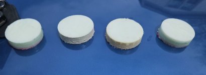

Here is what I ended up doing. Made 1/2" thick plugs in various sizes out of layers glass and epoxy. Then with thickened epoxy, set the plug in the middle thickness of the old hole and braced it in place while the epoxy setup. The next day, took a flap disk and dished out a 1/4" on the inside and outside. Then laid 5 layers of glass with epoxy going small to big circles on the inside and the outside. Once cured, faired it out with TotalFair and covered with Interprotect 2000e. Then installed the backer plate with thickened epoxy and one layer of glass on the inside. Then drilled the new hole and installed the new strainer and seacock.
