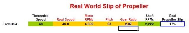

jherchel, Steele and rufus are giving you very good advice. I find your slip is at 17% and normally with aluminum should be about 11%.
I agree with them you should be running a 19" pitch prop. If you buy the same model prop you have now, you should have a speed increase of about 4 MPH and RPM about 5300 and much better acceleration to higher speeds.
Hope this helps.
