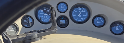

Thanks. I noticed that too. Shows 14.3 on the battery and same on back of alternator. My boat does that also. Not sure why. Faulty gauge maybe?

The voltage comes to the dashboard wiring via the B terminal on the ignition switch then branches off to the individual gauges, check battery voltage at the B terminal with the ignition on. Is it the same as the gauge or higher like true battery voltage? It could be resistance in the wiring to the gauges or even the red wire feeding the B terminal on the ignition switch. Maybe start with battery terminals & grounds. If the owner wants it fixed that is! It can take time to track it down.

I had this & thought the gauge was bad but it wasn’t. There was resistance in the circuit that feeds battery power to the fuse box. I wound up running a supplemental power lead to the fuse box instead of pulling the harness apart.

Thanks. I'll get into it in spring. Winterize yesterday and parked. Mine is covered and not thought about any more. Workin'on sleds now.
