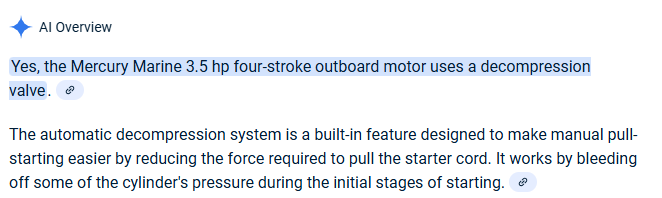

Looking at another thread here on iboats (https://forums.iboats.com/threads/3-5-mercury.777945/#post-5966759), and doing research online I have discovered that this motor has a de-compressor? Where? How to fix? Mine is very hard to turn over. I originally thought it was a valve timing issue, but the valves are driven by direct gear off the cam shaft. I took off the oil pan after draining the oil as it was due for an oil change anyway, and the cam shaft timing mark I found aligned with the gear shaft timing mark. The rocker arms and valves appear to be ok, nothing stuck. Using a feeler gauge the exhaust valve appears to be slightly tight at 0.1mm instead of between 0.11m and 0.19mm. I had actually thought it was much more out of spec days ago but I had mistakenly measured the gap. A second measurement showed me it was only slightly out of spec.

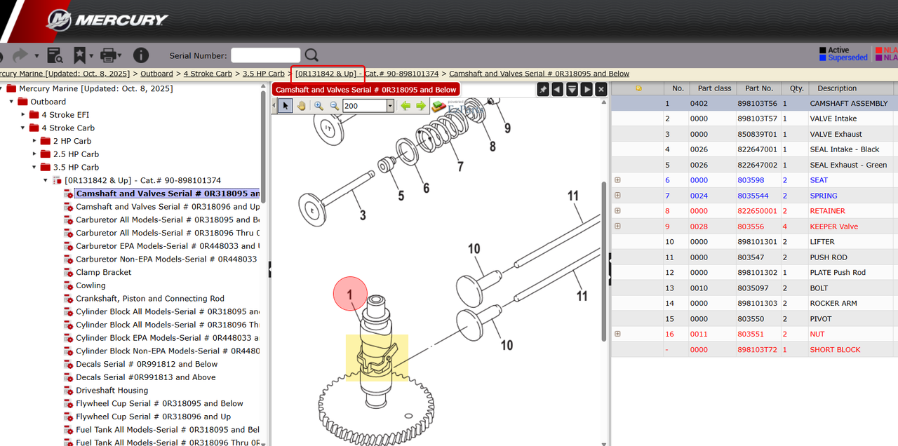

Something leads me to believe that the gizmo seen on the cam shaft for a Mercury Marine 3.5 four stroke model is related to the compression release mechanism.
I also saw that gizmo in the flesh... or in the metal... I have no idea what it does. It does move slightly. I can manipulate it slightly with the end of a pencil. But it appears totally connected to anything mechanically. I suppose I could try to fix it in one extreme position and then the other while yanking to see if I observe any difference in behavior. AI is definitely not the way to go here.
