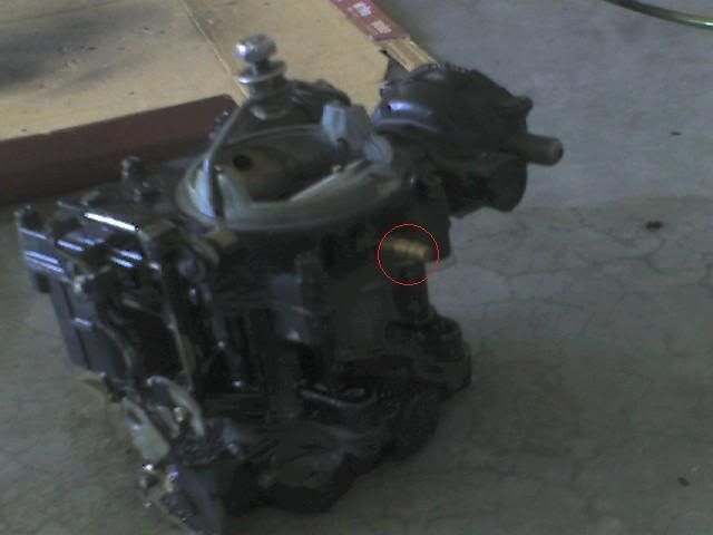

i tried cleaning the carb again havent tried it yet but there is a line coming off right below the choke that goes down to the fuel pump what is this? it was clogged with this sticky green crap

That line is there in case the fuel pump diaphram fails. If the diaphram fails it will dump the fuel to the hose and carb instead of dumping the fuel to the bilge ... safety thing.
