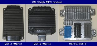

See if you can find the serial number. Look above the starter for a plate on the block. What year?
If no plate, which ECM do you have

ok then the ECM is not turning the injectors ON
When cranking do you see the tach show at least 300 rpm or maybe it doesn't move at all
F349479 serial Number Tach does goes up to at least 300 rpm
