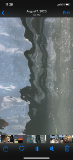

2007 6.2L MPI, sorry for not confirming. Starboard is fine. I have changed cool fuel modules, plugs and tune up shows nothing.
Im told that IAC may be it for $1.99 on this stream. Also s there a cap or ? I see theres a tune up kit and cap. Appreciate any help .

Definintely white, light grey and fuel smell. Compression tests and engines run great per Merc computer.
thx!! Ill keep digging

With fuel getting in the water I'm wondering if the fuel cooler has a leak. In your fist post you have said the cooler has been replaced
