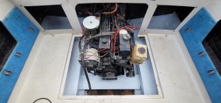

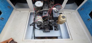

Hi Everyone, my name is Chris, new to this forum and new to boating. I recently acquired a 1977 Mercruiser 470 3.7. After settling in over the last few weeks looking over the boat and assessing it's condition, reading the service manual and numerous posts from this forum I have decided to undertake my first problem project with this boat, the "Leeky Cam Seals" issue. Wile cleaning under the oil pan I noticing coolant slowly dripping near the front left of the mounting bracket under the timing cover where the oil pan sits. "Photo 1" showes the coolant drip. No sooner had I discovered this drip I did some reading and came to find out this is very common with this engine. So being that this would be my first boat engin I've ever worked on I have come to this forum seeking assistance to the endeavor from you seasoned boaters.
My first question is, after reading this article from Sterndrive.com regarding the seal repair I wanted more information on a few things about the in boat repair scenario, specifically the lift procedure step on of the front engine. It appears the puller I will be using will have adequate room once the mounting bracket is removed. What I'm unsure of is how to properly lift the engine from the front with out without damaging the outdrive. I will be using a chain fall and Gantry system to lift the engine up from the front lifting loop. From what it looks like to me on my mounting bracket, please correct me if I'm wrong.

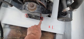

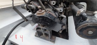

1st. I will unbolt the feet of the mounting bracket from the floor board.

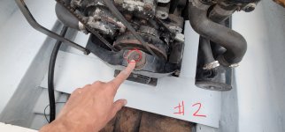

2nd. I will remove the top screw, not sure I need to do this.

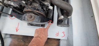

3rd. I will then use the chain fall to slightly lift the front of the engin just enough to remove tension from the mounting bracket and then remove the bolts from the bracket to the engine.
4. And finally, from what it seems to me I should be able to pull the entire mounting bracket away from the engine.
1st. Important question I have, before any lifting of the engine is done. Following the removal of the first two bolts of the mounting bracket, do I need to detach the back of the engine from the transom or the outdrive? I wasn't going to lift the engine but a few millimeters and the how to procedure from Sterndrive.com doesn't mention it but I wanted to make sure I didn't need to do anything else before lifting.
2nd. Question does is the rest of my plan of attack sound or am I miss something?
Thanks everyone in advance for your help, and please let me know if any more information from me is required.
Ayuh,..... Welcome Aboard,..... Pull the outdrive 1st,..... it's only 8 nults,....
Grub54891
Jun 17, 2012
6,076
I haven't done this paticular job yet, but will follow along and watch the progress. Bondo is right, pull the drive so you do not damage anything, and at that point you can service/inspect the bellows and gimbal along with alignment before lifting and after.
brian3127
Jun 10, 2007
507
the picture with the 2 on it. leave that bolt alone. just do pic 1 and 3.
but between 1 and 3 lift the engine before 3. then just take the mounting assemble out as one piece.

From the looks of the oil pan gasket it also should be replaced. Removing the engine will be easy since you have the equipment. After the drive is removed. Disconnect the electrical harness plug, the throttle cable, water supply hose, exhaust hose and the battery cable. The 2 bolts at the rear unscrew and the engine comes straight up.
There is a very good chance that the seal area on the camshaft will be pitted, you will have to get a Speedy sleeve to repair the surface.

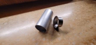

Seals arrived today, the installer piece was diffrent than the round piece I have seen in previous videos. I wonder if this is an improvement to the other installer part or just diffrent mfg design.
