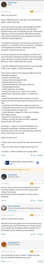

Lol hey guys look at the time stamps on the post
