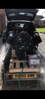

Here’s a picture of my water routing. Are there balls inside this housing?
One side has steam / water mix from exhaust - other is just water.

Ayuh,..... Is the motor sittin' Dead Level,..??
Superjetjim
Jun 5, 2010
246
Hi, looking at a picture from yesterday it’s leaning a little to the left due to the angle of the land I’m working off, but only a tiny amount - do you think the water is flowing towards the left hand side of the motor due to gravity hence why more coming out on that side? Is the cooling system really that rudimentary with no balanced 50/50 flow split?

Hi lads, just a quick update on this thread for the benefit of anyone in the future.
I mounted the motor onto a bench so it’s completely level (checked it with a spirit level)
Bondo was indeed correct, now the motor is sat level equal amounts of water coming out of both sides! Also both risers are now nice and cool.
No need to do a head gasket after all 👍🏻
