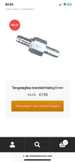

Hello I am new to the forum. I am from the Netherlands so forgive me some textual issues… I have the same issue, empty carb bowl after 3 days. My idea is to mount a return valve in the fuel line, see attachment. What do the forum participants think of this? Thank you for your replies, Karles.

You probably already have a valve like that at the tank outlet to prevent siphoning. So adding another one is not likely not solve your problem.

Tanks, I indeed read somewhere that the standard valve is in- or close to the fuel pomp. This valve is already 25 years old, so maybe out of functionality (?). I thought that an extra valve in the fuel line will not do any harm.
the valve is in the fitting at the top of the tank pickup. its a spring-loaded metal check valve. mine in the boat was over 38 years old when I last checked and working perfectly. that is well over 1500 hours of running thru that little check valve. other than dirt in the tank plugging them up, they generally do not fail.
