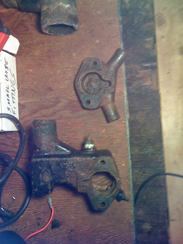

Pull the thermostat and test it. Suspend it in a pot and heat it up. With a thermometer, check at what temp it opens, if at all. While the thermostat housing is out, check for blockages. Post pics.

Here is the thermostat housing and cap
If there was a thermostat in this housing it is long gone. It doesn't seem like that would cause the riser to over heat
But this does.

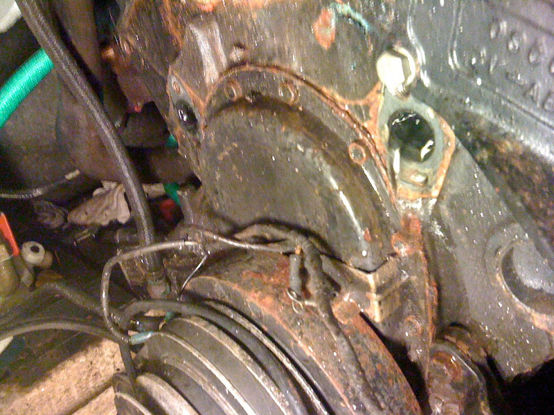

I went ahead and took the Engine Circulation pump off and back flushed it
It looks like the port side is fine but the starboard side had hardly any water coming out of it. So looks like I need to get that unplugged somehow. Any suggestions?

OK ...if your risers are clear and thermo housing OK you either have a pump issue or bypass issue so as stated in a previous post make sure you have the right hose set up and routing for your engine.
make sure you understand the bypass system and that it is set up right.
saw you backwashed ....are you sure no blockage at power steering cooler ?
As you say the risers get red hot in ten seconds after start up , that indicates they are getting virtually no water.
the only time I have seen this before based on all you have said is when the intake and outlet on the raw water pump were reversed ..... it is actually possible when hooked to muffs to get a small amount of water past the pump if it is hooked up wrong so check on that.
You also may have a considerable air leak ....crack in pump housing, etc
check belt to pump is tight.

Re: Mercruiser 350 Riser Overheating
Ya but how much water ....... saw your pic of water coming out of block ...if thats full pressure you don't have enough water hose pressure on muffs.
