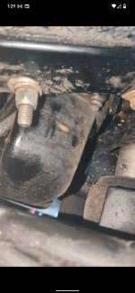

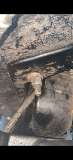

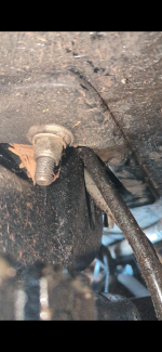

Snagged a few photos of the lower bolts, looks like I could access them pretty easily to attempt to tighten them. They don't look corroded but maybe in the transom they are. Any objections to trying to tighten them a bit? Looks like the exhaust has a connection there too that could be leaking.. If I do tighten them would that call for a gimbal re-alignment?

Tightening the bolts would not require rechecking alignment
Tightening the bolts may cause them to snap off IF they are corroded and have eroded internally. IMO, once something is old and starts leaking, tightening fasteners will have no effect
If the water is coming from the exhaust O-ring, tightening will not help
