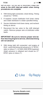

I’m trying to set the timing. And it will not go into base timing. I followed the directions first pic.

Here are the install and timing instructions you need to apply 12 v to the timing shunt (initial timing connector in instructions)to get it in base mode. Didn't look like you were doing it in the instructions you sent.
Without putting it in base mode you can't set the timing. Have seen a few people have trouble where their module is fubar and wont go into base mode. you could just set it to 24 degrees total advance at 4 k rpm as called for in the instructions.

I did exactly what was said in the instructions I just took a pic of the second page of it. I plugged the 2 white wires at the distributor thenDisconnect the shift interruptor switch and plugged the wires that went to the switch together. Then set the timing. Then connected everything back the way it was and the timing didn’t advance to 12 btdc. So that is why I’m asking if the ignition Modual is the correct one.

I did exactly what the paper work said. That didn’t work
So I tried to set it not in base mode. Started out at 650 rpm. Rotated the distributor to 12btdc. While doing that the idle raised.
So I turned the idle down and the checked the timing again and it went to 2 atdc.
The ignition modual is new last year. Because the old one didn’t go into base mode either. I’m just wondering is this the correct one. There are numbers on it to see what model it is. If anyone can locate the correct one I would appreciate or if this is the correct one. It’s not working right.
