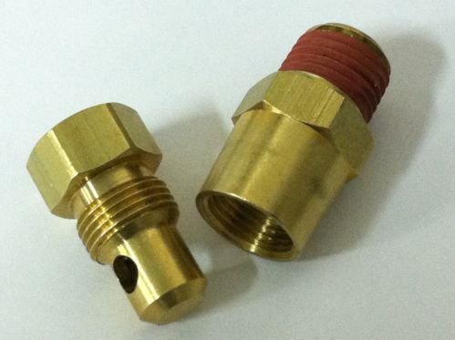

The brass stub is the brass nipple, use very small pipe wrench or disc wheel.then carefully unscrew the 90 deg fitting. Dont leave the threads exposed because the block will rust up. Install a brass plug or the brass fitting that takes the blue winged plastic plugs. I have never broken one yet, besides the brass plugs are solid

Ordered what you posted and it took care of it.
