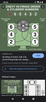

I have attached an image of how i think it is supposed to be connected, is this right? Also I have attached a pic of what my distributor cap looks like, i see it has two numbers is this if it turns left or right??
Ok. Quite plain to see what’s going on after you posted these pics.
So most normal LH rotation engines are 1-6-5-4-3-2 order.
Looks like your cap if it’s pictures as being the same as the one on the right showing that cap, is telling me that is a RH reverse rotation part. They are 1-2-3-4-5-6 I’m sure. Is it a LH conventional engine you have ?

If it’s left hand…you’d be using a conventional set up and be 1-6-5-4-3-2 firing order and suited cap. If it was a RH cap..I don’t imagine it would run hardly at all.

Would you suggest following this diagram to where the wires should be connected? Or is there another diagram with a different way to connect it?

You can reverse 2 plug wires and it wont even get on plane, just follow the diagram in post 7

I really am dumbfounded and will be able to try it this thursday, but right know it is connected like this the first number being the tower # the second the cylinder number going clockwise or LH. As per post #1 diagram
1 to #3 cyl
6 to #2 cyl
5 to #1 cyl
4 to #6 cyl
3 to #5 cyl
2 to #4 cyl.
Like i said it cranks fine 33 mphs.... i cant seem to find the reason or why it would be connected like this.
I will be changing the coil cable as i think it is also open
53,341
Never assume the tower on the dizzy is in a specific location. The tower the rotor is pointing to when the motor is at TDC is number 1
