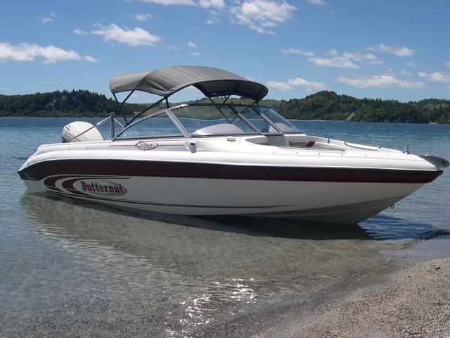

Hi,
Here is Butternut, a new to me Viper 1800 originally built in New Zealand around 2000 and with me since March this year.
I had the engine lifted today in order to reseal the mounting bolts but found a crack running the length of the transom underneath the transom cover strip. I assume that this is the original join between the hull and top, it does not look as if it was classed over by the factory.
My question is, can I grind out a V and seal the join with marine adhesive sealant or should I glass over it, or the answer I really don't want to hear - its something serious.
I have inspected the wood in the engine mounts, transponder mounts etc while rebedding and it is very solid, I am hoping the high salt content of UAE waters has prevented rot. There are no other signs of stress or cracking inside or outside.
Video coming as soon as I can upload it.
Thanks
Duane
