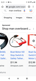

I put one of these on a Johnson 25 recently and it worked fine. No idea how long it will last.

I just don't want to chance it . If someone bought it, and it fits and works then there's no guesswork.

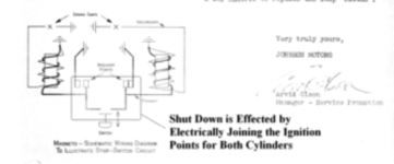

You have to install some wires on the breaker points.----May involve drilling the magneto plate.-----Fairly straight forward.----Or search for say a 1958 model 10 HP or a 63 model 10 HP or up to a 40 HP that did have those wires installed.---

jitterbug127 ... you should open your own topic this one is for a 9.9hp issue
killing involves joining the points via a normall open push switch... very simple but has explained the wires must exit the bottom of the mag plate to reach the switch mounted somewhere ... if no holes are available just drill one and protect thewires from chaffing with heat shrink tubing or rubber grommet
any similar automotive normal open "start" switch would work
or these....
