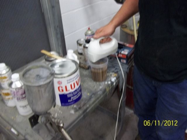

"IMHO one coat is all you need."
That would be cool!!!!!!!!!! Wonder if the ol girl is gonna use the whole gallon??? We will see tomorrow! Thanks Glenn

Re: Magnumdekes 1976 22' Starcraft Islander
Excellent progress:D
A coat in the a.m. and one in the p.m. would be totally fine I'd think. The first would still be cureing so the second would just cure right along with it. A chemical bond is better than a mechanical bond anywhoo. I'm with Glen though, I've only done one coat.

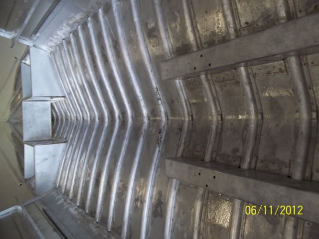

Hi Mag, I don't think a second coat of Gluvit is necessary. I think the first coat is your best (and only?) shot to get sufficient Gluvit into all the cracks and crevices. By the time you add a second coat, the first will probably have lost its vicosity and will prevent a second application from penetrating any further. It probably wouldn't hurt anything though. - Grandad
magnumdeke
Apr 13, 2010
626
Gluvit done!!!! one thick coat
Thanks Admiral for the mixer, will come be handy for epoxy too!!!!!!!!!!:eek::D

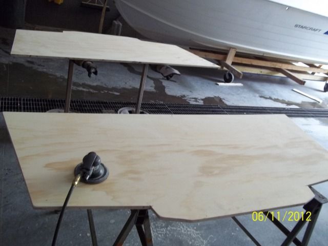

Hopefully I am not boring everybody with all the pics and detail, I just want to do a how to, or at least a how I did it:rolleyes:!!!

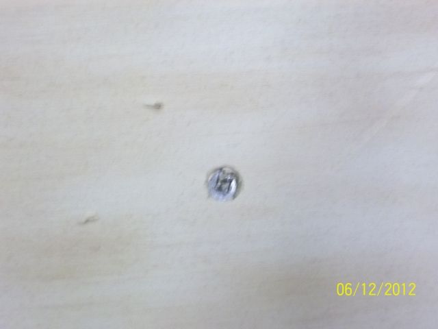

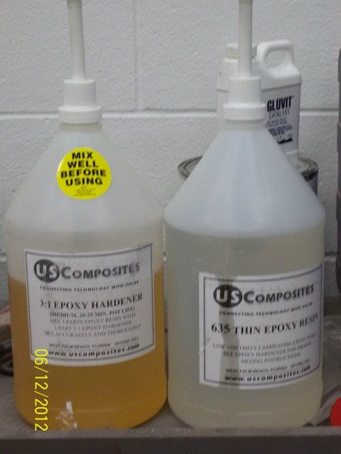

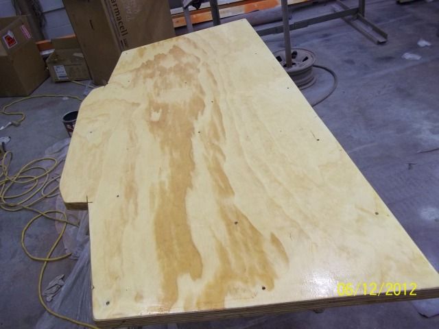

Transom, previously I had cut it, so I split it and sanded
Put a coat of epoxy on each side that was going to mate up on reassembly and then screwed it together with stainless screws
Stainless square drive 1 1/4" screws
Let it dry overnight, and coated one side this morning, slow progress but progress none the less
I will flip it at lunch and coat the other side!!
No such thing as too many pics or too much detail,........

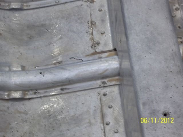

This may sound like a stupid question.
Does the gluvit have to go inside and outside the hull? Or is it just applied to the inside?
BTW, I think you are doing some great work here.
MichaelP
Apr 26, 2010
1,190
Making great progress. The transom is where I'd suggest multiple coats of epoxy.
NICE shop!
edit: I think gluvit on the inside for a couple reasons. Wicks better into most of the cracks and gets covered up anyway. I've seen it done on the outside but you'd want to feather it all out before painting.
Inside, that way you hide the ugly!!!!!!!!!!!
