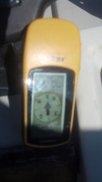

Well ol dauntless woulda liked to commit suicide and lay on the bottom for eternity, ahh Ya ok she don't leak a bit, wink wink. My goodness one and only one ride in that heap!!!!!!!!!!! Any who, the Islander is gonna fly with that 150,:D 38 to 39 mph gps, with a half full hull of water and not running max rpms, was getting 4500 rpms, guessing it should go higher. I think once I am done restoring the 150 she will be mint! Damn strong runner in the powerband for sure! anyways pics in a bit, i'll be back.
Ya this pic sux, gps I had along

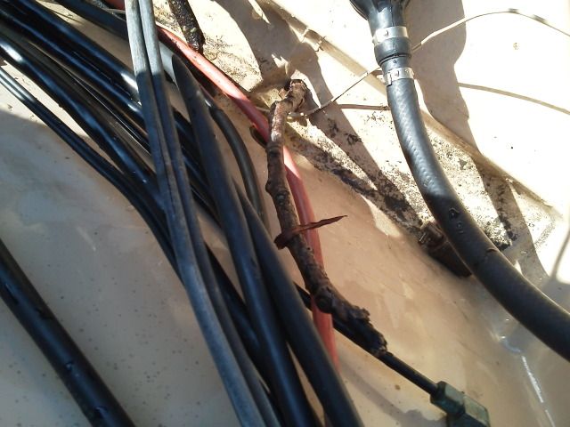

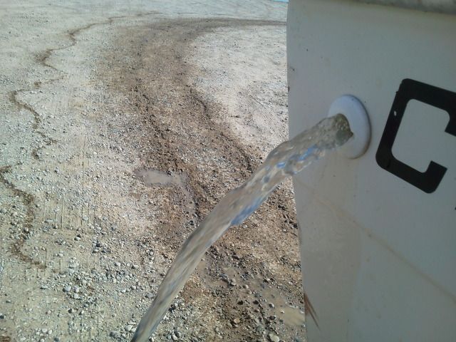

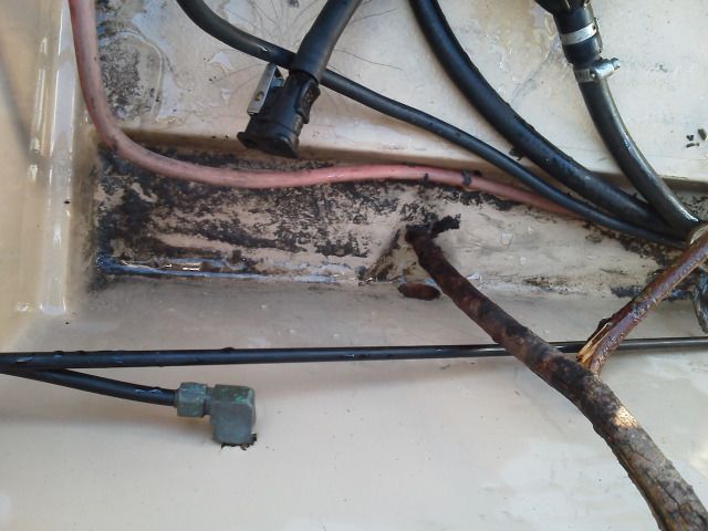

Leaked like crazy, two holes drilled through splash well into the bilge compartment that I did not notice, somebody wanted to make sure the broken bilge pump had something to try to do!
Local sticks to somewhat plug em
Lot of water drained out for 20 minutes after recovery at the launch, bilge pump and drain plug

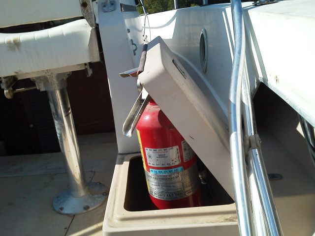

Brought this along to deal with potential problems from fuel leaks 10lber

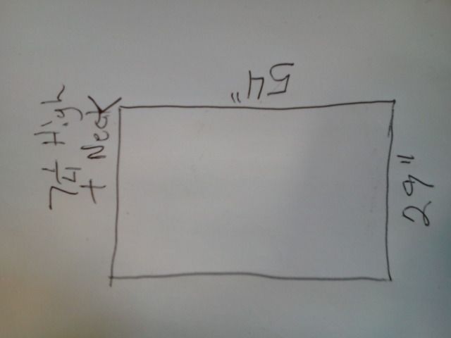

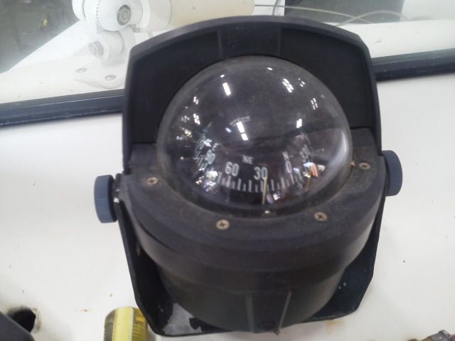

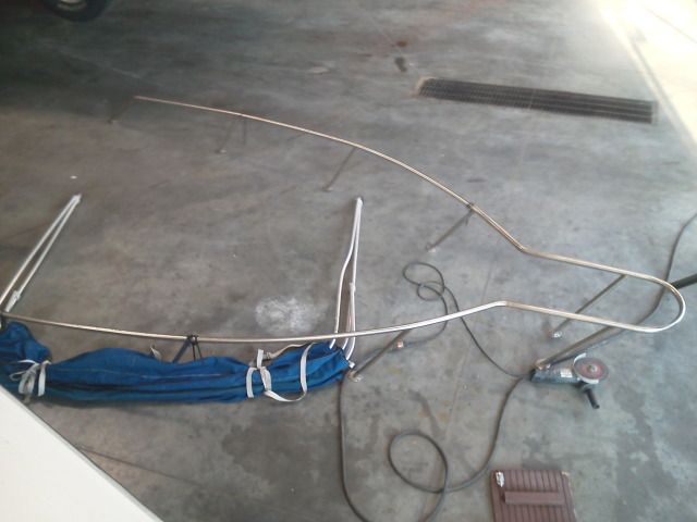

sorry not the trailer! Slowly taking some goodies off, gotta get the trailer empty before deciding on that. Recovered a fuel tank tonight, aluminum and a little to big to fit the Islander I am afraid, Bummer for sale though! Popped the bow rail off, I like it a lot, all welded stainless. Going to try to fit if, like the bow pulpit that goes with. Compass looks like it will work, gps or not still a good idea to have. Want to have Dauntless stripped and gone this week. Cell phone pics, not the best or most tonight!
Rectangle ,no hump in the bottom, no plate on it, think it works out to 50 gallons
Not a ton of progress but progress!

Man that tank would be awesome for the Islander, you sure it won't fit?
magnumdeke
Apr 13, 2010
626
Re: Magnumdekes 1976 22' Starcraft Islander
Ya stringers are 24" apart, tank is 29", may have a plan yet, not sure if it will work but I am going to scope it out.

MD - with the way you bend aluminum, could you spread the stringers by 5" to make room for the tank? Since the bracket grew on the back the stringers are now only for floor support and no more motor support/tie-in.
