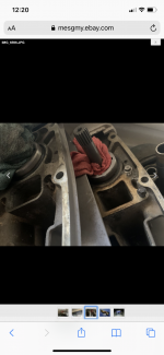

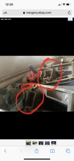

a guy is telling me there are 2 different ones, does anyone know what style mine would be? A copper tube goes there. Really wish I had pulled it apart before going into storage

Right, but some are telling me that gearing is in my upper so the lowers are the same, need a merc, I can’t find any 1.66 with the same I’m guessing the pipe is a water pick up. They all bolt on and mine just seals up tight.( the copper pipe)
53,264
if its an SX, the gearing in the top transmission is all the same across the board and the gear ratio change from 4-6-small 8-large 8 is all done in the lower gear set.
