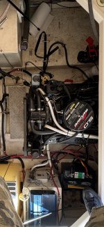

1998 MerCruiser 5.0 with Alpha 1 Gen II
I have a slow-ish leak through the transom. About every 5 seconds I'll get a quick, thin stream of water. I can take the boat out for 3 - 4 hours and I'll have about 3/4 inch of water in the V of my bilge.
Ideas on what this might be? I checked the bellows but they appeared fine. I'll re-check them more thoroughly as soon as I can (boat is at storage at the moment).
Any ideas of where to check first?
I'm also now concerned about transom rot. I've taken it out twice while it has been doing this. How real is that concern? This is a fiberglass hull cabin cruiser.
Thanks in advance.

Took the boat back down to the water with a borescope to see if I could narrow down what's going on.
Drain Plug​
At first I didn't see anything, but I did notice the small amount of water in the bilge had a ripple. I spent a while trying to find where it was coming from before finally putting the scope down into the drain plug. That's where I found a leak.
One thing to note though - this is not where I originally saw water coming from. This appears to be a new/different leak. The only thing that's changed is I recently removed and reinstalled the drain plug. I also noticed there was some grit in the threads while tightening it.
While removing and reinstalling the plug, I also noticed the drain plug housing itself rotates a little. That doesn't seem right to me.
I tightened the drain plug back up, put the boat back in the water, and it was still leaking, but from a different spot around the plug.
So now I'm wondering if:
  • The threads are damaged.
  • There's still grit in there preventing it from sealing.
  • The rotating housing means I need to pull it and reseal the whole thing.
I attached an example of the style of drain plug I have.
After I got home, I figured I should probably just reseal the drain plug housing. When I removed it, I found that two of the screws were short and didn't appear to have any sealant on them at all. The third was a much longer bolt and had quite a bit of sealant on it.
Turns out that long bolt also attaches a ground wire on the inside of the boat under the engine (picture attached). So now that ground wire isn't attached to anything.
Unfortunately, I don't think I can even reach it without removing the water heater and fresh water tank. There's just not enough room to get in there on a cabin cruiser.
Water around the hydraulic housing inside the transom plate.​
I also spent some time looking around the hydraulic housing area. My borescope isn't the greatest quality, so it's hard to pick up really small drips. I left it sitting there for a minute or two and couldn't actually see water coming in.
After messing around with the drain plug and coming back about 15 minutes later, there was a small pool of water there. I still couldn't find exactly where it was coming from, but it was definitely accumulating.
At this point my questions are:
  • Any tips on the best way to reinstall and reseal the drain plug housing?
  • Any tricks for reattaching that ground wire? Right now I really don't see a way to get to it without pulling more stuff out of the engine compartment.
  • My next thought is replacing the gasket around the hydraulic lines. Does that seem like the next logical step, or is there a better troubleshooting path?
  • I haven't drilled the transom to check for rot. Seeing that two of the drain plug screws didn't appear to have any sealant has me wondering if I should be more concerned about that.
Also open to any other thoughts if anyone thinks I'm headed down the wrong path or overlooking something.
