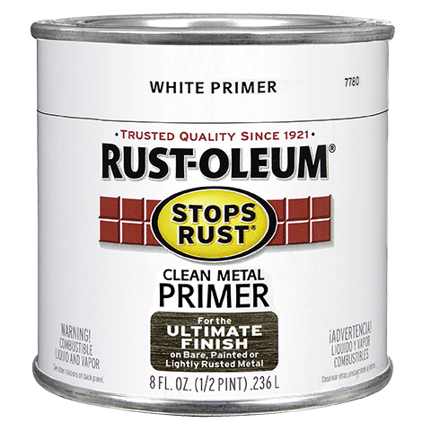

I wouldn't use Zinser. I WOULD use Clean Metal Primer made by Rustoleum. It works great on wood, fiberglass and metal.

Thanks for the replies, going to grab some Rusoleum Primer at lunch today.

Is the Rustoleum Clean Metal Primer a sandable primer? Can you sand it like other primers for body work?
