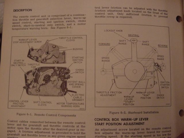

Damn service manual won't be here til Monday. It was shipped "economy mail" by mistake. Somehow it's going to take 6 days to get from Massapequa, NY to Syracuse NY! :mad:
The seller was nice enough to offer to send pics from the manual(he had other copies) regarding the link & sync...and also from the controls.
According to what I've read so far, there is a 45 degree shifting radius when shifting into forward/reverse...so I'm guessing that explains why it takes the control lever so much travel to start affecting the throttle. I still think I'm going to have to adjust the length of my cables a bit though.
I'm going to check a few basic things with the 'link&sync' (cam follower start point, etc), but am not going to do much more til I physically get the manual in my hands.
Looks like I'm going to have to buy a timing light and learn how to use it...cause I'll need to confirm timing with a timing light.
Don't get ahead of your self by guessing, And NO way, there's not suppose to be all of that travel in the throttle before responce from the engine,....think about that:confused: what purpose would that serve?, it's just what I said it was, review earlier post. A well tune power pilot and engine is as responsive as a mothers arms. you have to get your mind around the sync proccedure to see it.
my setup starts effecting throttle timing a hair after gear engagenemt followed immediatly by throttle butterfly movement, I can make my engine lope at low idle with just tiny pressure back and forth on the power pilot, I use the throttle to make minor adjustments in the no wake zones so it has to be responsive at all settings...it was designed to be.

I def didn't plan on guessing on anything. From what I've read, I should be able to handle the link& sync, but I'm going to wait til I read the manual thoroughly before I dive in and make changes.

I'm going to be taking apart the control box later today to see what's going on in there. I did crack it open a hair and saw some cobwebs etc so I def needs to be cleaned/lubed. I also want to test the overheat buzzer to make sure it's working.

the power pilot is a can of worms, be careful in there.
