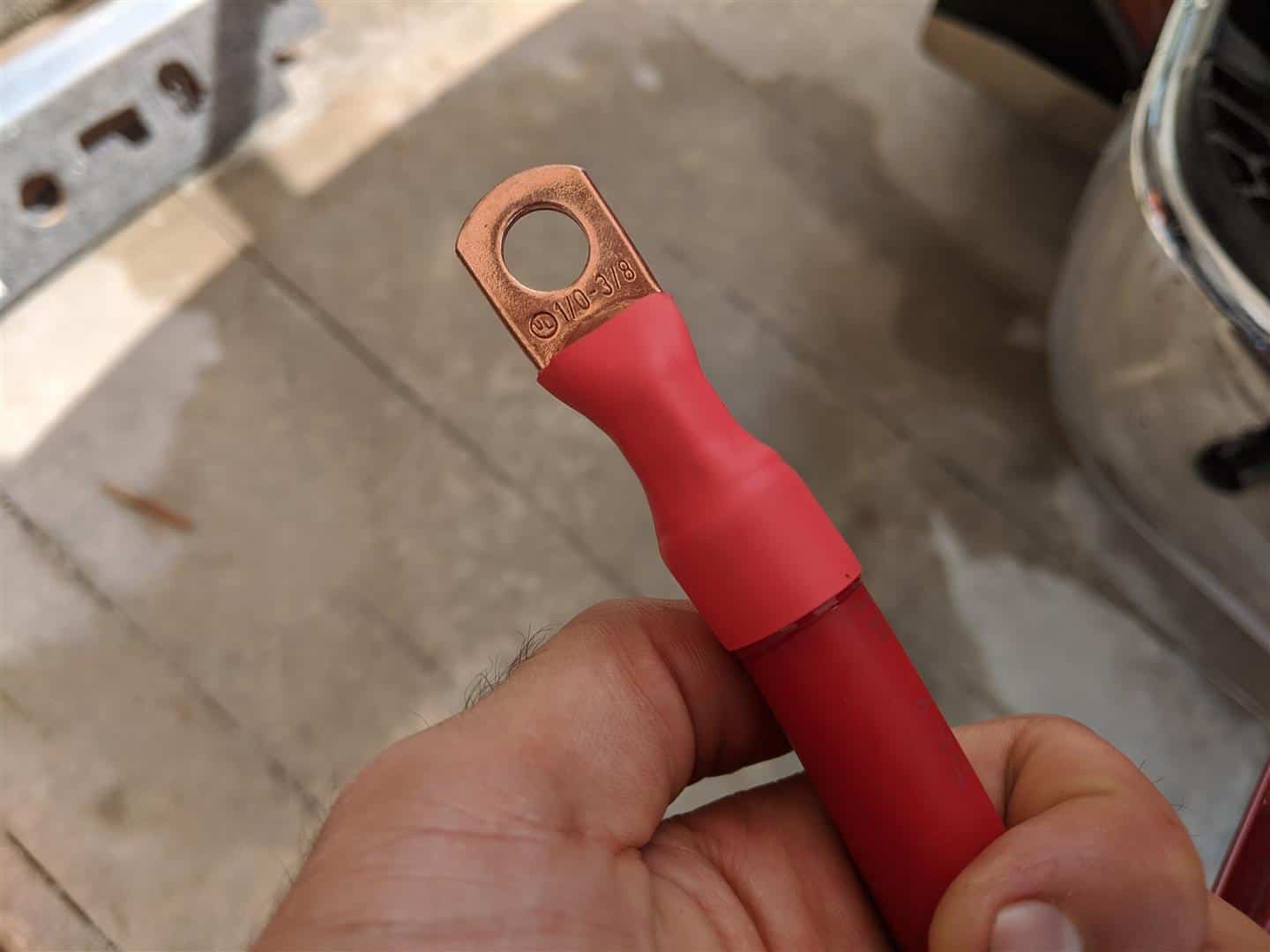

bruceb58
Honorary Supreme Mariner
Mar 5, 2006
30,820
or a custom battery pack (there are companies that make custom packs out of the individual cells) I think @bruceb58 even makes custom battery packs using the plastic marine cases that look like ammo boxes.
I make my own packs but I basically 3D print the case plus some aluminum plate.
There are so many options out there these days, I probably won't make them anymore like this. Was a fun project...it's the reason I bought a 3D printer.
